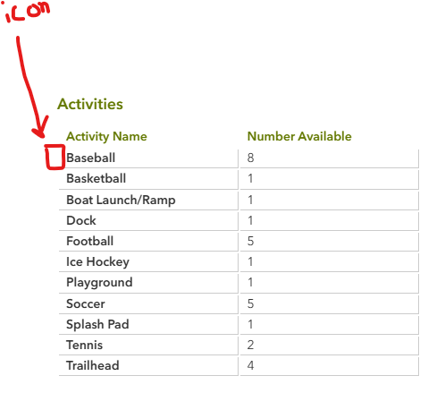

I have a code segment for a popups in a Parks layer. I have a bunch of features on a different layer called Recreation that contains the locations of different activities and amenities. There's a matching field which I'm using to filter out Recreation points that don't correspond to a given park. Then I use GroupBy to generate a table that shows how many of each activity are in the park. It works pretty darn good! What I want to do to really make it pop is add icons to this table. The recreation points layer has a field called iconPath that contains a hyperlink to an icon stored on my server. Each distinct RecType is points to one specific icon on the server. As an example, every point where RecType = Basketball has a iconPath = '<file path>/Basketball.png' So my table and count works great, but I really want to add these icons before the activity name.

I feel like using GroupBy to get this table constructed is going to prevent me from doing this, but is it possible to access more than one field from that GroupBy feature set?

Give this a try
var activities = GroupBy(fil2, 'RecType', [{ name: 'NumTypes', expression: 'RecType', statistic: 'COUNT' }, {name: 'Icon', expression: 'iconPath', statistic: 'Min' }])
You can use the Min and Max statistics on string fields. In your case, each would give the same result, since the paths are the same for each RecType.

ZachBodenner
MVP Regular Contributor
With some tweaking on my styling, this will be perfect! I didn't know you could just do multiple groups within the same groupby function. Thanks Ken, great advice as always!
