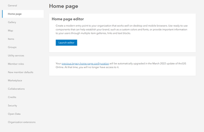

I had the same problem. The Group I was trying to delete was a Featured Content Group. I received the same error message: "This group cannot be deleted as it is used in your organization's settings.". The problem turned out to be that the Group was set as a Feature Content Group in ArcGIS Online's previous legacy homepage configuration.  Go to the Organization page. Click on Settings. Click on Home page. Under Homepage editor there is another block which contains a hyperlink: "previous legacy home page configuration" Try clicking on that, scroll down to "Featured Content".  I changed mine to  "No featured content". Click done. I was then able to delete the group when I went back to the group page and clicked delete.

If anyone is still running into this issue after the March 2022 update you can no longer change the legacy home page settings. The link will let you view your previous home page but no options to change the settings. If you have a Feature Content Group set you can configure it using the api in an ArcGIS Notebook. This will set the homePageFeaturedContent to a dummy group that does not exist and let you delete the current.
