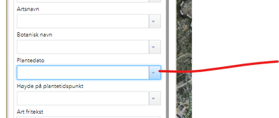

I am setting up a WAB Smart Editor widget and want the current date to automatically today's date. I have tried to do this under Attribute Actions -> Preset, selecting my only date field and setting the Preset value to Current. This does not change anything, the date is not preset and has to be chosen manually. I have watched the Get smart about editing-videos and I cannot see what I am doing different. What am I missing?
I also struggle to set a preset value for a text field that will hold the name of the person registering new features. I have set the preset value to blank, but if I fill this out it does not register.

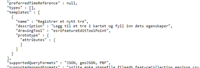

The technical reason why this is occurring is the attribute template is not listed in the feature layer JSON for this field - and actually any of the fields in your service. This can occur when fields are added to the service in a certain way such a through ArcGIS Pro.
The good news is we have a fix for this that will be released tonight USA PST, so it should work when you try again tomorrow! Let me know if you are still seeing issues with your presets then.
