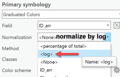

DanPatterson
MVP Esteemed Contributor
try log normalize
