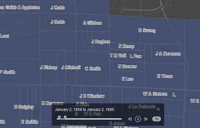

Notice the way the Time Slider appears in a map:
As with the other examples, this element can't just be reassigned to a panel. You can have a widget button (under the search bar, for example) that launches this widget, regardless of the theme chosen, but that's it.
