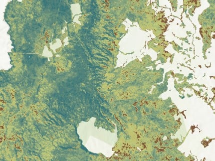

I have a TIF file that looks like this in ArcPRO - Lighter colour representing light forest, and darker representing heavier areas. There is a value chart in the layers that shows the values 1-9 (light to dark).
So, I made the layer as a package to share to ArcGIS online so I could have the raster visible in the application. This brought it in as a Tile Layer (Hosted) (see below), and when I add this layer to the application, I only get the RGB information for the layer, whereas I need the colour band/value as I had in ArcPRO so users can see a better legend representing the lows to highs.

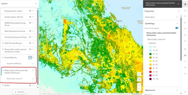

This is the details of a different TIF layer in the application that shows the values represented by the different colours. This layer is also a Map Image Layer in my content. This is what I need for the maturity forest layer.

This first screenshot is the layer that works or projects the information as I need with a value symbology.
And this is the layer I created myself that doesnt seem to allow the value symbology, just the RGB.
As mentioned in the earlier post, the layer that works is in my AGOL as a Map Image Layer, whereas the raster I brought in is a Tile Layer. Would this have anything to with the differences maybe?

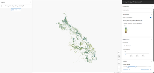

I completed the steps you recommended by selecting Sharing>Share as Web layer and changed the Layer Type to Tile. This has brought the raster file into AGOL map but as a Basemap. But if I add the raster as a new layer it appears to be correct, showing the density legend as required (see below).

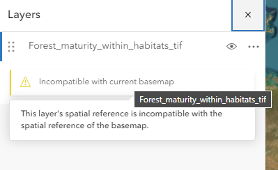

This is fantastic, however if I turn off the original inputted layer that came in as a Basemap, and change to any other Basemap, the Layer I added does not show. I get the error below. I read online that this might be due to a different coordinate system used. So I'll have to have a play and see if I can convert the layer to the correct/corresponding coordinates before bringing into AGOL and see if that fixes the new issue.

@mtuffy I'm glad you're getting closer! The default coordinate system AGOL uses is the Web Mercator (WGS84). For the imagery/raster layers I've published, I've published other coordinate systems then WGS, but AGOL normally reprojects it to WGS to display correctly in any web map. Normally though, I just use WGS unless there is a reason to do otherwise.
You may be able to move the published layer you have from basemap to a layer. Normally, there's a setting option when you look at the layer in the web map contents panel that will say something like "move from basemap". This may be worth trying? Once you move it, you should be able to select a new basemap.
