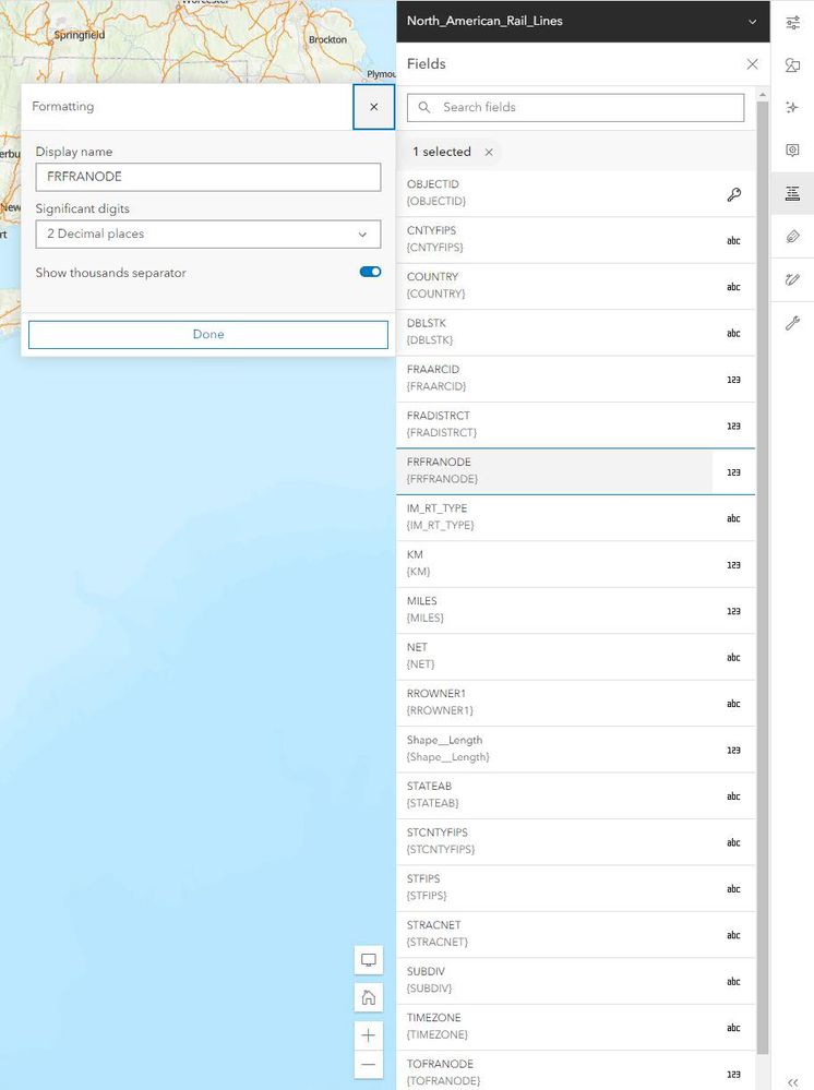

I'm trying to remove the thousands separator from some numeric fields (Northing, Easting, and others).  I see many solutions with an internet search but these must apply to Map Viewer Classic because the suggestions are not available in the new Map Viewer.
I tried changing formatting in .csv but this isn't working.
Can someone please provide a solution that works in New Map Viewer.
Thanks to all.

Select your layer, and then click on the fields section. Click on the field of interest and you should see the toggle for the thousands separator.

Fantastic.  Thanks, Steve.
