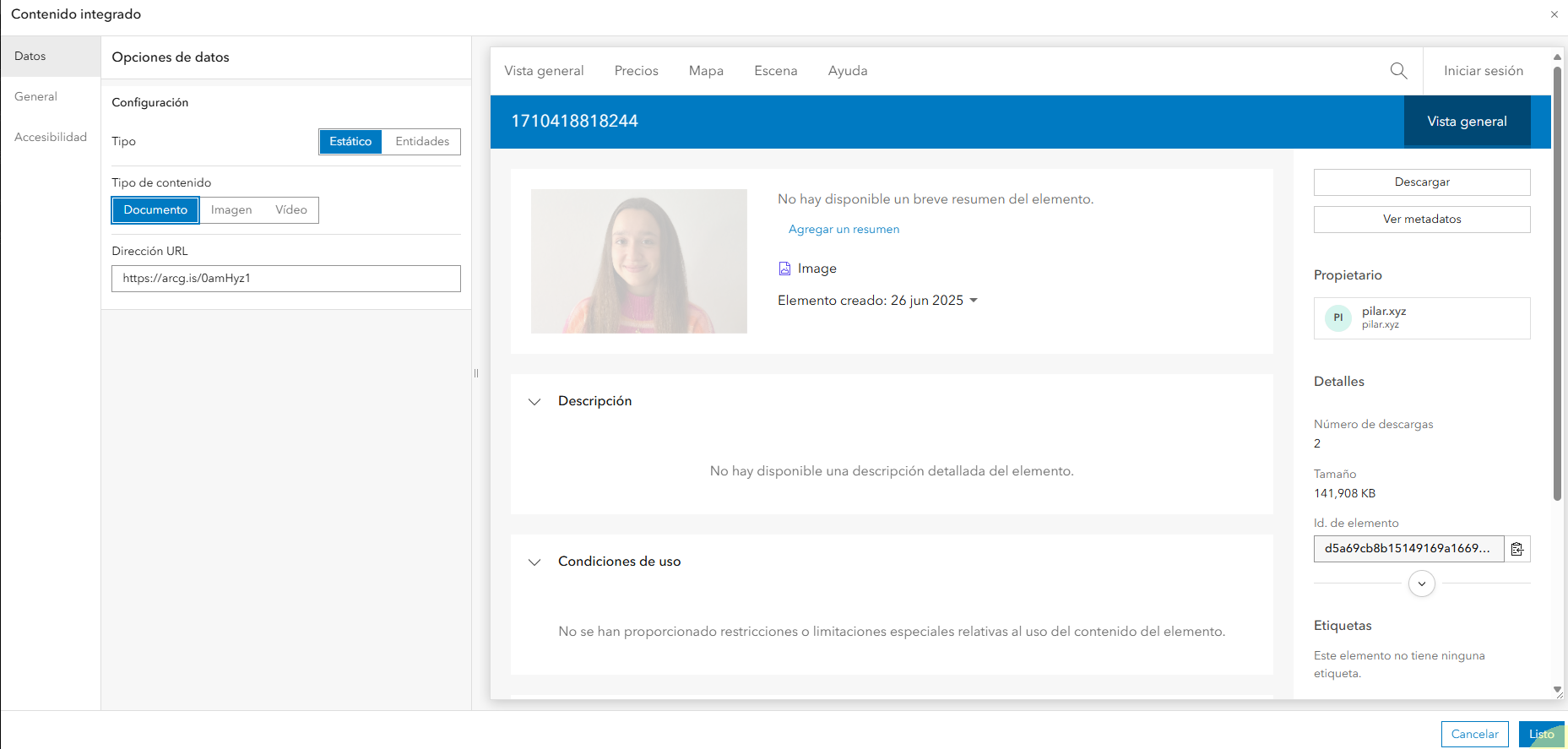

I'm Pilar, product owner for ArcGIS Online at Esri Spain. With the new update, we can't find or don't know if the new update prevents us from viewing the URL of items. If we click here, it takes us
to the previous element view...
And if, for example, we want to insert an image hosted in our ArcGIS Online, in an application such as ArcGIS Dashboard, instead of embedding the element itself, the image from our content, it copies the previous element view, like this:
Does anyone know if the links are somewhere but we are not seeing them, or if it will stay like this, or how we can embed images, for example, in dashboard from our content?

Hi @PilarBravoViñuales and @Nick_Creedon thank you for sharing. This has been reproduced and logged as BUG-000177466: Image items in ArcGIS Online no longer show a link to the stored image on the item details page, rather "share with others" short URL points to the item details page following the June 2025 ArcGIS Online release.
There is a workaround to right click on the thumbnail from the item details page and copy image address.
