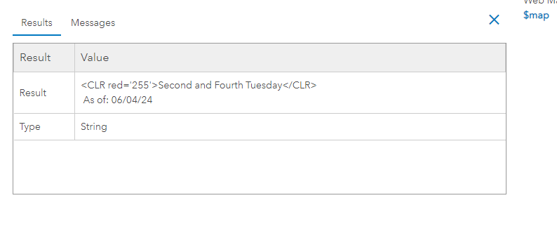

Hello, I'm trying to format the following to have the feature value to show up as a red text. However, AGOL wont recognize this (as seen in the attachment).
the source code is as follows:
else if (time >= Date(2024, 05, 01) && time < Date(2024, 06, 01))  {           //This is june-month's are zero based
return "<CLR red='255'>" +$feature["JUNE"] + "</CLR>" + ' ' + TextFormatting.NewLine + ' As of: ' + time3;
} else if ....
Any advice?

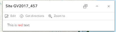

Unfortunately, AGOL does not recognize the formatting tags used in ArcGIS Pro. If this for a popup, you can use an Arcade element with html tags like this
var output = `This is <span style="color:red">red</span> text`
return {
	type : 'text',
	text : output
which gives you a popup like this
