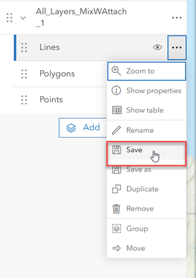

2. Save the settings to the item

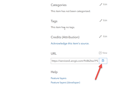

3. Go to the item details page of the item, and scroll to the bottom. You should see the ability to copy a REST url

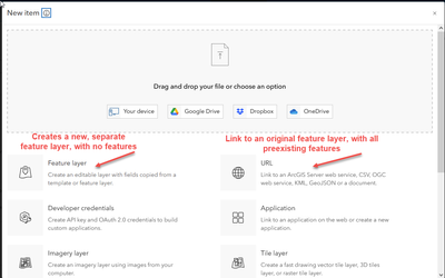

4. Go to My Content and start creating a new feature layer. Select "Provide and ArcGIS Server URL"
5. Paste in the copied link. This should carry over the settings that were saved to the original item

Hi @JacobLyons, are you saying that when you copy the URL and create a NEW feature layer (pictured below on the right) it is creating in duplicate features in the original item? If so, this is a bug and should be reported to support.
I cannot reproduce this by following the steps I outlined above, so if you have a reproduction case that'd be helpful for me to take a look
