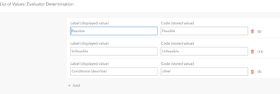

AliciaMcMurchie1
Yes, dropdown list values generated from Survey123 are domains. I see this when I open up the domain editor:
