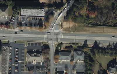

I am new to ESRI GIS.  I need to migrate a Googlemap base app to ESRI.  I really can use some help and guidance.  I need to create a hybrid map in ESRI on arcgis.com that shows the following:
1. poles
2. cables
3. traffic light
I attached a sample map here that shows the above.
I looked through a lot of the ESRI base maps but I just could not find the right combination for it.
Any help is greatly appreciated.

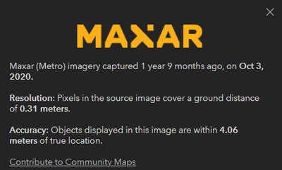

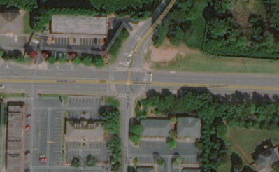

Bing Hybrid has comparable
Currently the OOTB Esri one does not have that resolution imagery for that area
Using the Imagery Updates App You can see the contributor for this imagery is and resolution info.
https://www.arcgis.com/apps/MapSeries/index.html?appid=27236479807f43e9ac3ff65d6777e324
