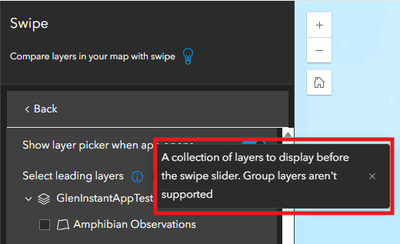

GlenterpriseUK
Adding to @MohammedSubair comments, until 12.1 Group Layers are not supported in the Swipe functionality on Instant Apps
