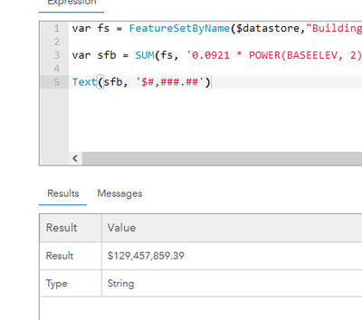

Here's a test output from the Arcade Playground's sample layer:
