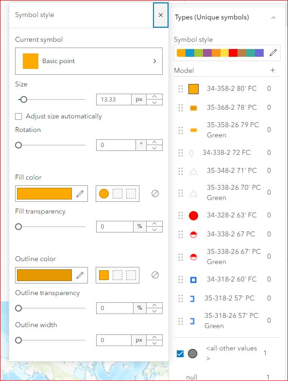

1: I figured out how to make changes in Map Viewer(new) but the fill option is still greyed out. Is there another method? I also tried looking in field maps and in the content settings for the group layer.
2: See pic 1 and pic 2. Pic 1 shows me successfully changing a symbol's fill that I uploaded from Pro. Capture.JPG

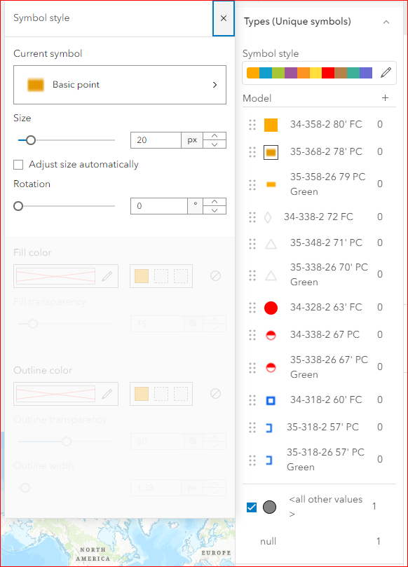

 I've noticed that I can change the fill for symbols chosen in the "arcgis 2d" symbology galley (not from esri AM/FM Sewer and Water fonts which I need). If this is the case, it harshly limits my options and makes emulating someone else's (cad architect) symbology impossible.

I've tried this on my end. When selecting the layer in ArcGIS Map Viewer, then selecting Styles, and then selecting Style Options under Location (single symbol), I get the same greyed out Fill Color:
When selecting Basic Point and then selecting one of the shape options, it gives me the option to edit the Fill Color:

The fill is disabled bc the symbol is a picture marker symbol that could be coming from Map Viewer Classic symbols or a Symbol by URL from a MVC map. If you use a vector symbol like the ones published from Pro to a map or as a web style and used in Map Viewer these will support tinting the symbols if they are picture marker symbol, if its a marker symbol you can do full color swaps.

I don't see this option when sharing the web layer (see pic 1). Perhaps it's only when sharing a map? I'll give it a try.
