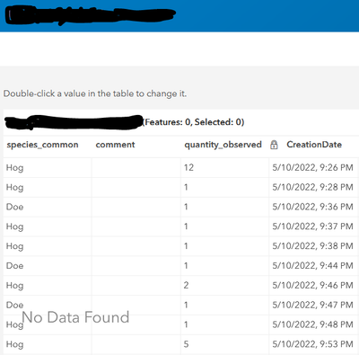

A few more things to add. In the Field Maps (version 22.3.1 on iOS) app, behavior is normal.
Behavior in the data table is also odd. The attached graphic shows this. Zero features but records are shown in the table?
I opened ESRI case # 03338055 about this issue.
