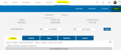

You can also check the Credits tab in the Status section of ArcGIS Online.
You'll see a Credit Utilization Chart. This chart is interactive and allows you to drill down into different credit usage groups and some of them will allow you to download a report.

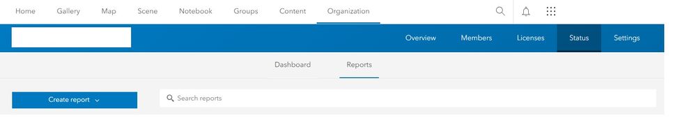

@GeoNomad thank you for the response and this is exactly what I was looking for. Can you please tell me from where I can download the two CSVs in AGOL?
Question | Analyze | Visualize
GeoNomad
Sure no problem. You would go to the Organization Tab in ArcGIS Online, then Status, then Reports, then Create Report, then Single Report. You need to generate 2 reports. One for Item and Member.SS.jpgSS.jpg
