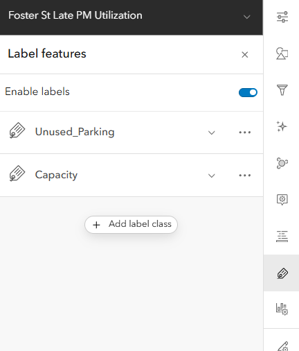

Hello, I need to include the labels to my features in the legend. There doesn't seem to be a way to do this.
I have green labels showing unused parking for some features and red labels showing capacity for other features. How can this be included in the legend?

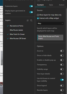

In EXB you can customize which layers are shown in the layer list:
I hid my labels layer but it still comes up within the legend widget!
