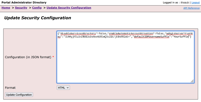

Addendum: I finally got around to test it. Here is how you can configure a suffix for IDP users on ArcGIS Enterprise:
More information for the defaultIDPUsernameSuffix can be found here and you can configure the property through the portaladmin interface:
Click Update Security Configuration, then update the JSON string by adding "defaultIDPUsernameSuffix": "YourSuffix".
Then click Update Configuration. Done.
