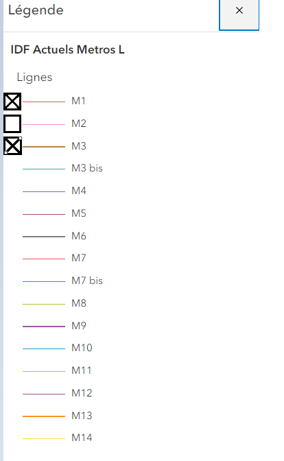

I have a feature layer of line of metro in Paris. I used the name of the line to create a "classification" to have a coloured symbology for each line of metro.
But, now i want to integrate in my map a simple fonctionnality : the possibility to show and hide certain line of metro with a click on a checkbox or watherver.
Actually, it's impossible from the layers windows to select which line i want to show or hide.
I want to know how it's possible to do something like that :
It could be on the legend, or in a "layer controller windows" it doesn't matter.
I just want to allow the users that use the application to show and hide what he want.
It's supposed to be a basic things in GIS, but i don't know why, i didn't find how to do that...
It might be simple but i need your help to find this feature.
Thanks, have a nice day !

In any case, i have not only the lines of metro to integrate, i have like 20 different features to integrate, and i want to have the possibility to choice what i want to see like on the picture i sent in my primary post.
There is no more easiest solution ?

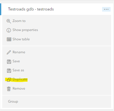

You can use Map Viewer and do this.
1. Duplicate layer
2. apply the filters to show/hide the values you want from each layer. Easiest way to do this is use Filter > Include & Exclude.
3. On the layer you want to hide from legend  set this toggle to off on the properties panel
