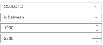

I've done something similar, since you have the time in 24 hour format, you could drop the colon, and reduce it to 1030 and 2200, then use "Is between" in the filter menu, that would bring things in that range:
The only INT field I had was OBJECTID but you'd use yours:
If this doesn't work for you, just let me know and I'll get you an Arcade script if needed!

@CodyPatterson, thanks for your answer, but the idea is to make this run programaticaly or dynamically.
i want to show the data only with the system time is between the two date fields, knowing that the fields are "FromTime" and "ToTime", SQL where  will be something like this:
"FromTime >= CURRENT_TIMESTAMP() AND CURRENT_TIMESTAMP() < ToTime"
so it will be great to do this with arcade 🙂
