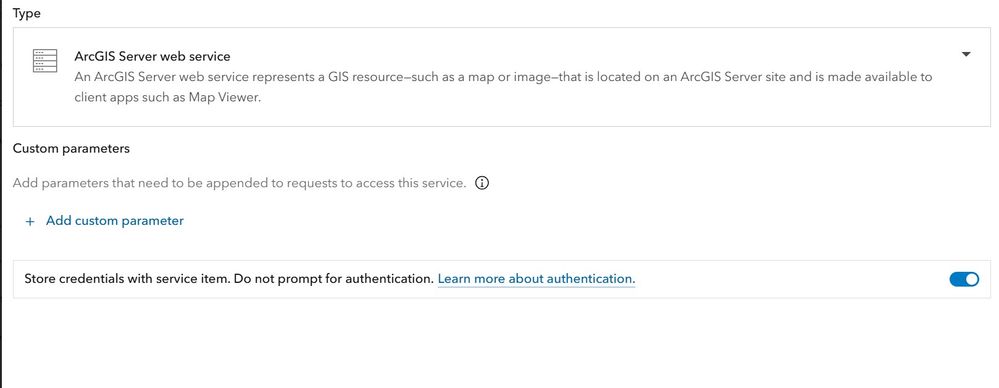

Thanks for responding. We are working with a software vendor that needs to consume some of our utility features in an AGOL map. We created a map in Pro and published to our Portal and set the sharing to organization.
When we go into AGOL to add item > URL and click to save credentials.

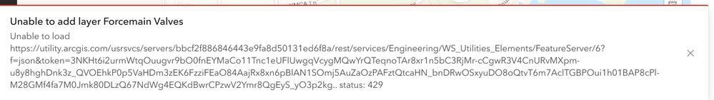

It works or it says it does. But when we go to open the map to view it takes forever to open and some features will usually not show but give a warning "can't add xyz feature or only partly add the features then they disappear. We also get this error message at the bottom.
