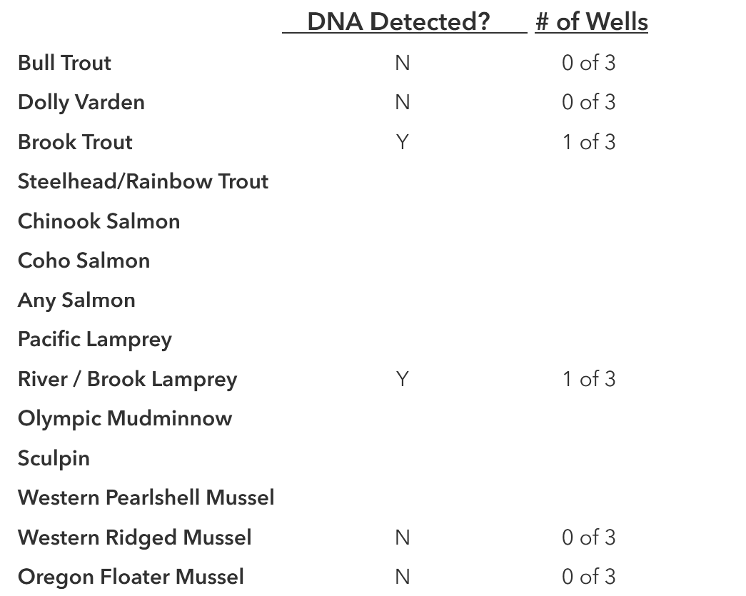

This is what the table looks like without the filtering
I would love this format, but filtered to hide all empty data.

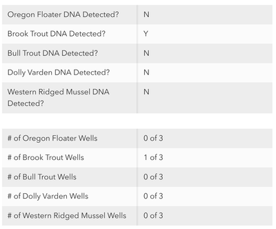

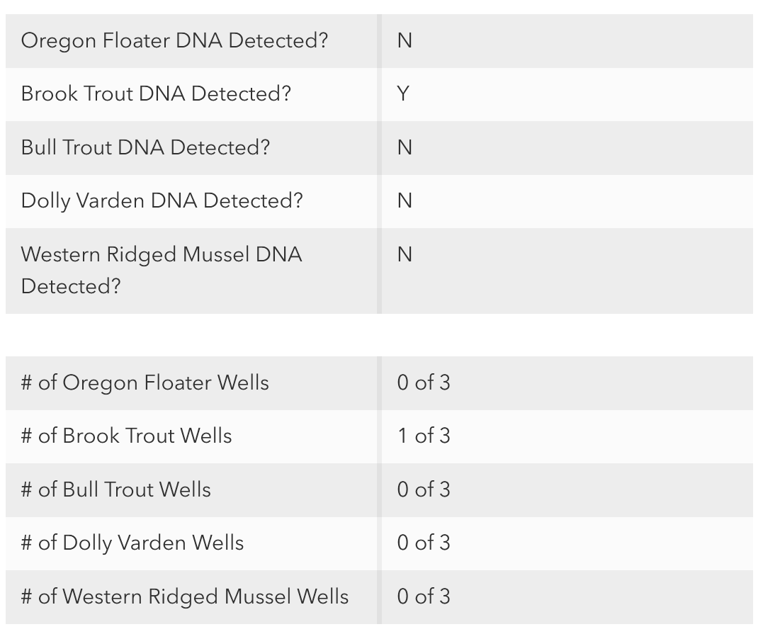

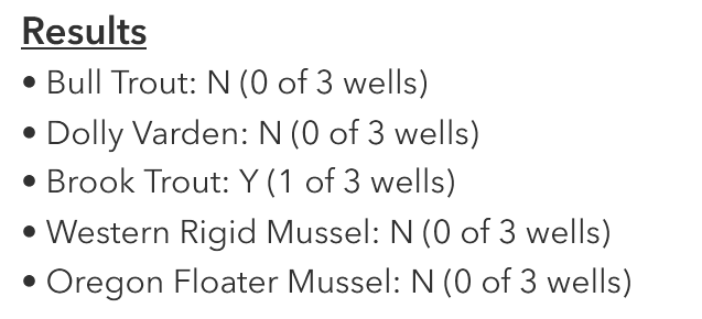

Here are a few clunky alternatives I was able to create.

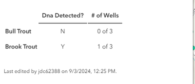

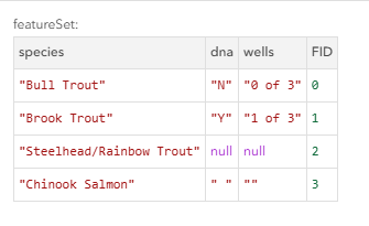

So, assuming you have a feature service you can access that looks something like the following:
You can access and loop through to create a table that looks like what you provided pretty easy using an arcade element in your popup. The code would look something like:
var fs = FeatureSet(def)//replace with whatever call for your data
//style tags
var th_tag = `border-bottom:1px solid black;border-spacing:15px;padding:8px;text-align:center`
var td_tag = 'padding:8px;text-align:center'
var sp_tag = 'padding:8px,text-align:left'
//initiates the table and defines column header data cells
var table = `<table><tbody><tr><td></td><td style="${th_tag}"><strong>Dna Detected?</strong></td><td style="${th_tag}"><strong># of Wells</strong></td></tr></tbody>`
//loops through featureset (fs) and returns a new row for each data point with the appropriate attirbutes
//you will need to replace f['species'] with the appropriate column name from your dataset, as well as the others
for(var f in fs){
  if(IsEmpty(f['dna']) || IsEmpty(f['wells']) || f['dna'] == " " || f['wells'] == " "){
    continue
  table += `<tr><td style="${sp_tag}"><strong>${f['species']}</strong></td><td style="${td_tag}">${f['dna']}</td><td style="${td_tag}">${f['wells']}</td></tr>`
table += '</table>'
return {
  type : 'text',
  text : table
The result is a HTML table just like the one you included a screenshot of:

Wow! Thank you for your response. If I could get this to work, that would be incredible!!!
The rows in my table look like the following
     DNA Detected?      # of Wells
Bull Trout
{BULL_DNA_Detected}
{Num_BULL_Wells}
Dolly Varden
{DOVN_DNA_Detected}
{Num_DOVN_Wells}
Brook Trout
{BRKT_DNA_Detected}
{Num_BRKT_Wells}
Steelhead/Rainbow Trout
{MYKISS_DNA_Detected}
{Num_MYKISS_Wells}
Chinook Salmon
{CHIN_DNA_Detected}
{Num_CHIN_Wells}
Coho Salmon
{COHO_DNA_Detected}
{Num_COHO_Wells}
Any Salmon

Based on what you posted above, it looks like your dataset might look more like this, given that each point you are defining a pop up for has an entry similar to the one below:
This makes the looping a bit different, and adds another step, but still completely possible! The code for this would look more like below.
