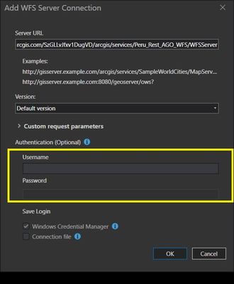

I am afraid that this is not a supported workflow.  Please, have a look at the page Publish hosted OGC layers. There is no mention of securing these. If you were to share the WFS without sharing it with everyone,  client software such as ArcGIS Pro, Map Viewer, Map Viewer Classic, would not be able to add the service.
Here is an attempt to add a WFS created from a hosted feature layer in ArcGIS Online, with ArcGIS Pro. The WFS has not been shared:YF5Y9ZFOvg.jpg
The text box for adding credentials is greyed out.
Sharing the WFS with everyone allows one to add the service without issue.
Hope the above is of use.
