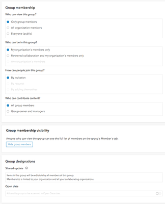

The Group settings are as follows:
Shared Update does not allow Update Shared Update.pngShared Update does not allow Update Shared Update.png

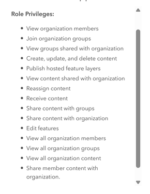

The user is a Creator type with the following role privileges:
Shared Update does not allow Update View_role.pngShared Update does not allow Update View_role.png

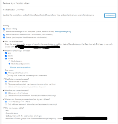

The item settings are as follows:
Shared Update does not allow Update View_view Settings.pngShared Update does not allow Update View_view Settings.png

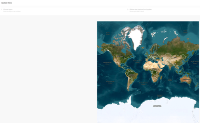

Here is an example of the greyed out view the user experiences:
Greyed out header and no left-hand barGreyed out header and no left-hand bar
