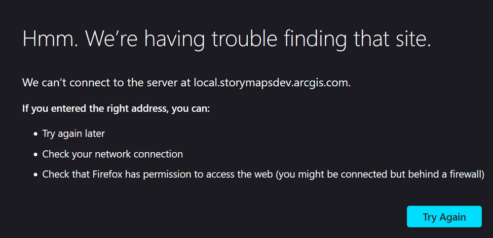

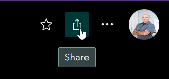

My students have created ArcGIS Online Collections, and have been directed to use the 'Share' icon to create a short url for their collection, to add to their Resume, etc.
This example produces this link: https://arcg.is/1PnLfX

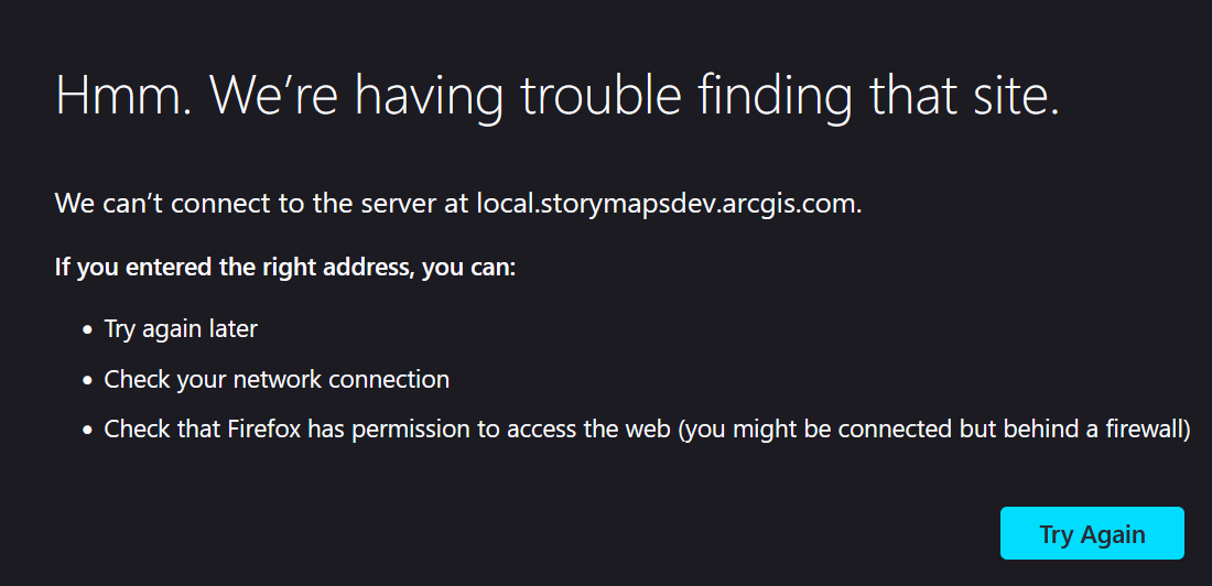

Which results in this 'error':
At first I thought it was the permissions, but when I copy the students 'Long URL' from the Collection:
https://storymaps.arcgis.com/collections/566bdc6433f94e1caf9761b418ce4f54
It works perfectly fine.
All this was done using Mozilla Firefox, latest edition. 121.0.1 64 Bit on Windows 11.
