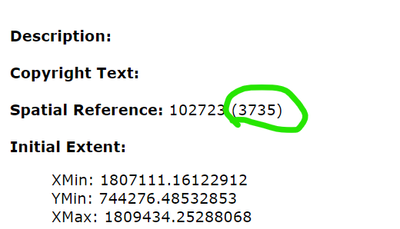

Nick_Creedon
Your map and layers can be different projections, layers in AGOL project on the fly so your layers can be visualized in another projection.
To see what your layer is projected in on AGOL, go to your layer and view URL
There are sites like this one the help you find out what your layer is projected in :Coordinate reference systems (epsg.io)
You can see mine is 3735 which is my local state plane, you can search this on the website. There is a certain way you have to share your layer to AGOL for it to project properly. If you make your layer in AGOL it will always default to Web Mercator (3857)
How ever your layer is projected in AGOL is how it will export.
