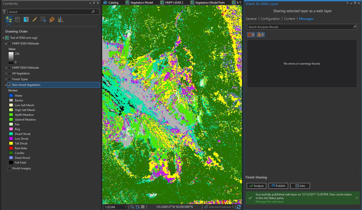

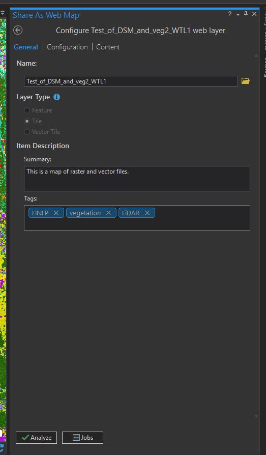

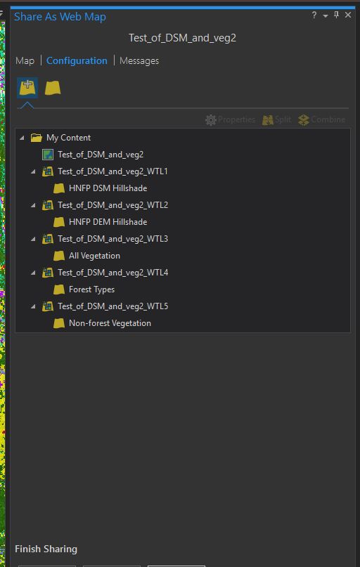

I will watch the tutorial. I have reviewed the help files but I feel like I am still missing some details. It explains how to split layers, for example, but does not tell me why I would do this. Analyzing does not report any errors but I am wondering if grouped layers are not supported... The images below are from a current test that involved splitting layers. Not done uploading that one yet... Previous attempts have otherwise had the same configs.
Here are the screen grabs in the meantime.

Since you have raster data you are creating a tile service. You could publish each layer separately and add them to you webmap to enable switching layers on and off.

I think I have worked things out. Your feedback was helpful. I have been choosing the option to automatically cache but I guess that does not insure that it actually gets built by the process initiated in arcgis pro.
I have also been getting hung up by the "split web layer" requirement for projects with multiple layers. I am wondering if it is possible to choose split web layers as the default?
