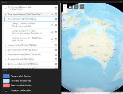

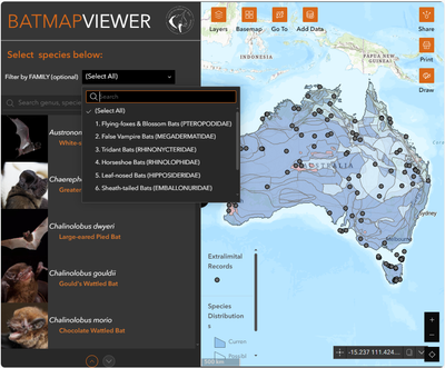

Not ideal, but the final design I opted for was a list widget to display and filter all of my species. And instead of 'grouping' I opted for a filter widget to filter species based on my groups in my list widget. Screen grabs of my original app and my updated app below.
One possible alternative would have been to add a second list widget to act as a filter for my first list widget, but that would have involved creating an entirely new table in my backend which I didn't want to do. I encountered a couple of other technical difficulties as well. I hope ESRI comes up with a better grouping mechanism at some point, they appear to have taken a backward step with Experience Builder on this one.
Regards, Damian
