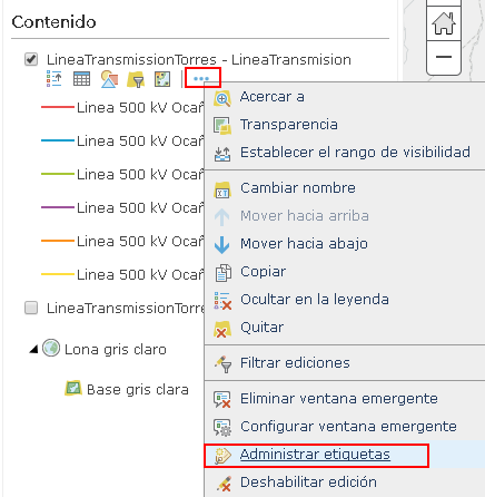

If you are basically looking for a way of showing the length of a segment, in case the lines are individual features between points or intersections, you can simply label the length, like displayed below (sorry for the Spanish interface).
To get there, you click on the 3 dots next to the layer in ArcGIS Online and select the option create labels:
