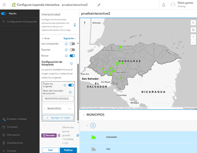

I want to create a map which I can search through a specific layer I have, but when I want to add the layer it doesnt display and I can configure it. In 2022 I create a map which I could do that and I opened it in 2025 and it still works. Thanks for your answers.

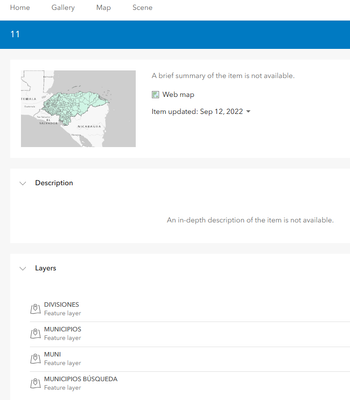

This map I created in 2022, I could add a search layer...

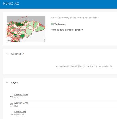

Your 2022 map ("11") contains feature layers, but your new map ("MUNIC_AO") only contains KML and GeoJSON.
If you can configure your MUNIC_AO map in the same way you did your older map, you might have better luck.

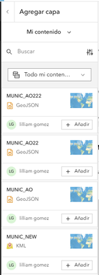

It doesnt allow me to add feature layers, just the geojson and kml, I tried with the map of 2022.

Regarding the question about configuring Search by layer for Web maps, the option is only available when the Web map consists of a Hosted feature layer, ArcGIS Server feature, or ArcGIS Server map service layers with Query enabled (doc).
You could probably test this out by adding any Hosted Feature layer to the map from ArcGIS Online or ArcGIS Living Atlas. In your case, the Web map consists of KML and GeoJSON Feature layers, which are not searchable. Public accounts do not offer the functionality to publish Hosted feature layers, which is why you don't see this option under Web map settings.
