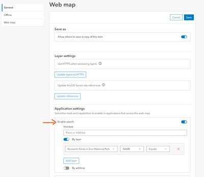

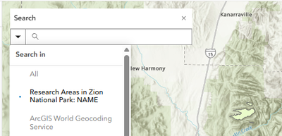

Hi @lilliamgomez, to enable searching by layer in a Web map in Map Viewer or any application consuming the map, we would need to first configure Search by Layer under the Web map settings. We can find this configuration on the item details page of the Web Map (as shown in the image below).
Once configured and saved, the Web map will list the Layer name in the Search drop-down menu.

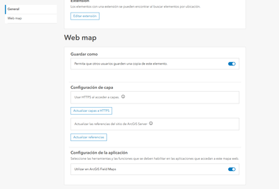

lilliamgomez
I cannot find the option Enable Search. The image below displays what I see.
Katie_Clark
MVP Regular Contributor
@lilliamgomez  If you aren't seeing the option to Enable Search in the web map settings, it is likely that the web map does not contain any layers that are searchable.

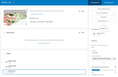

lilliamgomez
I cannot find where this setting enabled is. This is the screenshot of the web map and the layer I want to use...
Katie_Clark

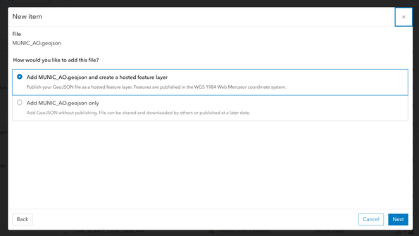

Ah, yes that's just a GeoJSON layer. You will need to add it as a hosted feature layer. Select this option when you add "New Item" from your Content page and select the geojson file:
Once that hosted feature layer is in your web map, you should see the Enable Search option and you can select that layer from the dropdown.

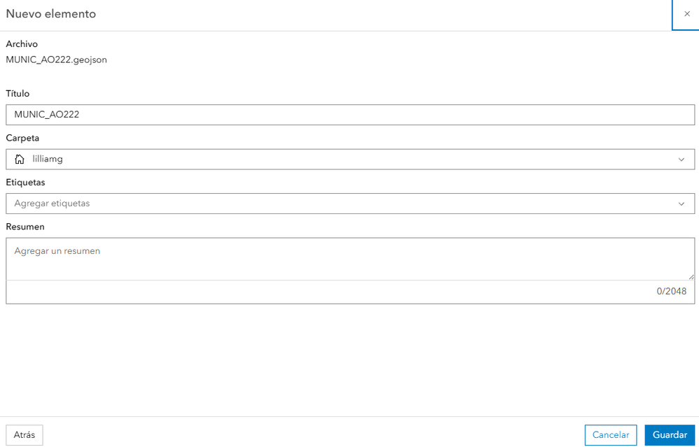

lilliamgomez
When I want to add an item, the option you presented doesnt appear in my window...
Katie_Clark
What is your role and user type in your organization? Looks like you don't have the permissions to create hosted feature layers.
