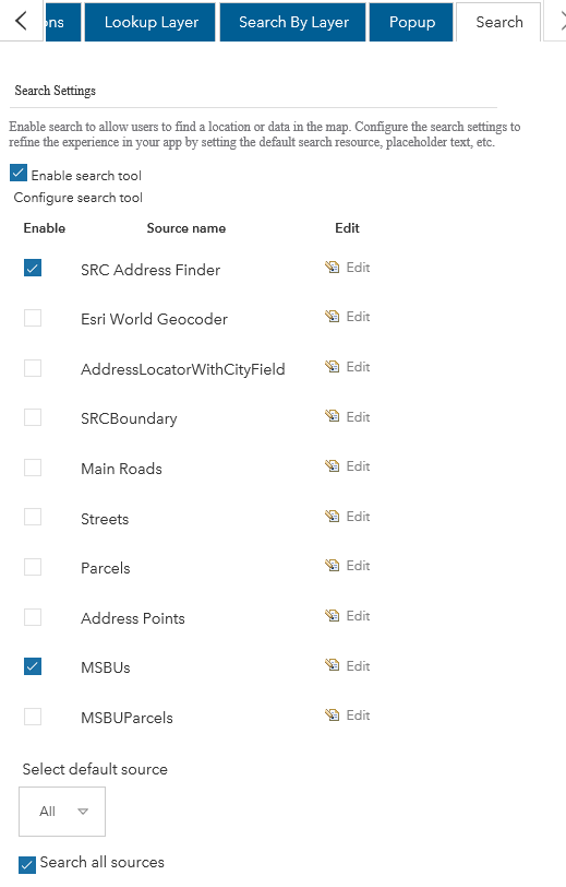

ElizabethBrumfield
Yes, when a user clicks on a  parcel inside the MSBU polygon, their parcel data should appear.  Here are the lookup layer and search tabs from my app. I have experimented with all different combinations of both.  I either end up with showing all the parcels in a MSBU (too busy), or like I have it now - nothing showing.
