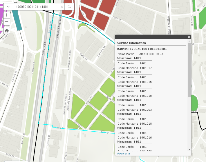

Hi Elizabeth Brumfield ,
Sorry for the delay, but as far as I understand, the Lookup Layers setting will define which layer information will be displayed. At this moment from the screenshots I notice that your MSBYParcels is switched off:
For instance in my case I have 2 layers defined:
... and when I search I get the information of both layers back:
ElizabethBrumfield
Yes, I see that - but see how that give you the list of all the manzanas? I don't want to show the individual features until the user clicks on them.  I think I've got it working now, though. Thank you for your help!
