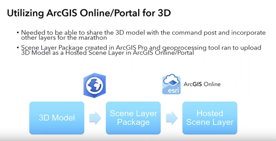

I'm using ArcGIS Pro 2 Patch 2 (2.2.2).  I unsuccessfully tried to share from ArcGIS Pro a Scene Layer Package .(slpk) to ArcGIS . I then unsuccessful tried to load the .slpk from my desktop to ArcGIS .
I'm seeing that it may have been possible to do so, but now it is not.  This video (44:57) shows the workflow:
The  documentation when I looked on 10 September shows that displaying .slpk is not supported.

Displaying scene layer packages(.slpk) in ArcGIS Online is not supported. You need to upload the slpk to ArcGIS Online and from that slpk publish a hosted scene layer from your scene layer package to ArcGIS Online. This is similar to tile packages(tpk) will display as hosted tile layer and vector tile layer packages(vtpk) to hosted vector tile layers. Make sure you have a privileges to publish scene layers with your organizational account.
