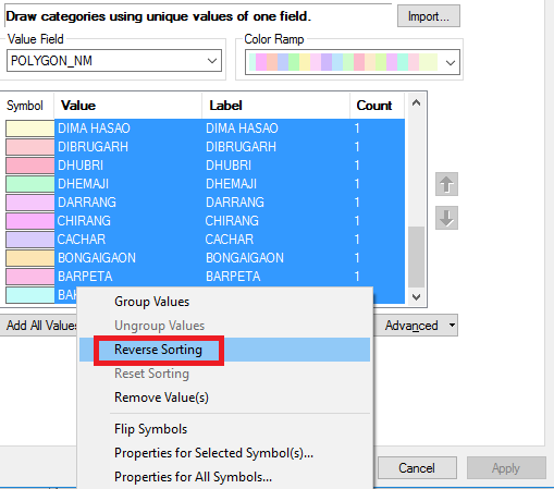

If you are asking about sorting the attributes in Symbology, you could select all the values > Right-click > Reverse Sorting.

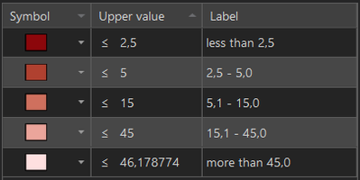

Hi, in ArcGIS Pro I reverse symbol order, and then share it to ArcGIS Online.

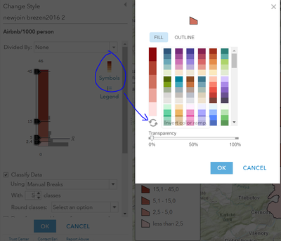

Open in Map Viewer, click on Change style Dialog, click on Symbols (colours) and then here is a ''reverse symbol''.
Here is the official link with answer: https://doc.arcgis.com/en/arcgis-online/reference/styling-reference.htm
