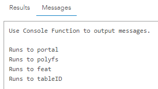

Hi @Sergio ,
What version of ArcGIS Enteprise are you using? This is to check that Arcade functions are available at this version.
What field data type is 'HydroID'? If it's string field, you'll need quotes in the SQL query:
Filter(polyfs, "HydroID = '"+tableID+"'")
At what stage of your script is it failing? Use the console() function, Test, and Messages tab to see how far the script runs to. Something like:
var portal = Portal("https://www.arcgis.com/");
console("Runs to portal")
var polyfs = FeatureSetByPortalItem(
    portal,
    "4dbbad3d6f694e0ebc7c3b4132ea34df",
    0,
    false
console("Runs to polyfs")
// Create empty feat variable
var feat;
console("Runs to feat")
// Populate Feature Array
var tableID = $feature["FeatureID"];
console("Runs to tableID")
This will help narrow down where the issue lies.

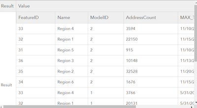

Sergio
Hi @CarmelConnolly ,
I'm on Enterprise 10.8.1 and it seems like this is  the cause of the issue because I could run this Arcade in AGOL.
I use the same datasets as in examples and "HydroID" is an integer type, but thanks for clarifying this important nuance. The only difference is that I don't call these layers from original source - I've made a copy for testing purposes and all layers are on the same web map.
Also, I could run this code only in test mode in Arcade editor, but when I tried to display result of this expression in popup it shows no data. And in editor when I click TEST it takes a while till something renders in results window. This lead me to another question - is this a proper way to do this at all? I mean in terms of performance on larger datasets it will work very slow, I presume. is this correct?
One more thing  I've noticed - this expression works like a standard join and shows ALL matched records in result table, but I was hoping that it will show only the data related to the particular polygon. Here is what I see in results:
And here is my exact code that returns above results:
var polyfs = FeatureSetByName($map,"FC_polyfs")
var tablefs = FeatureSetByName($map,"T_tablefs - T_tablefs")
// Create empty features array and feat object
var features = [];
var feat;
for (var t in tablefs) {
    var tableID = t["FeatureID"]
    for (var p in Filter(polyfs, "HydroID = "+tableID)){
        feat = {
            attributes: {
                FeatureID: tableID,
ModelID: t["ModelID"],
                AddressCount: t["AddressCount"],
                MAX_TSTime: t["MAX_TSTime"],
    Push(features, feat)
var joinedDict = {
    fields: [
        { name: "FeatureID", type: "esriFieldTypeString" },
        { name: "Name", type: "esriFieldTypeString" },
        { name: "ModelID", type: "esriFieldTypeInteger" },
        { name: "AddressCount", type: "esriFieldTypeInteger" },
        { name: "MAX_TSTime", type: "esriFieldTypeString" },
    'geometryType': '',
    'features':features
// Return dictionary cast as a feature set
return FeatureSet(Text(joinedDict));
Is there a way to implement this as one to many on 10.8.1 where one polygon renders multiple records in popup from separate standalone related to this particular polygon by one particular key field?
