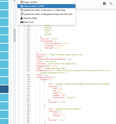

Here's another idea. Create a "master" web app that serves as the template for all the others. In AGO Assisstant, you can see the JSON of the web app:
In fact, as you've made that sample public, I can view it as well:
The JSON will depend a lot on the contents and configuration of the app itself, but you'll be able to spot the layer IDs and the service URLs. All you'd need to do is to copy everything else from the "master" app into the various species specific apps, but keep each pointing at their own layers.
It would still be a bit of manual work, but altering the JSON can be done programmatically as well via Python and the ArcGIS API.
You might even consider using something like GitHub to track the various JSON files and work with them as external files, then use Python to read the JSON into the update_definition function on an app.
Edit: another thought! This might be a data management nightmare, but suppose the relevant layer groups (ranges, models, ALA) were each a big layer with species as a field. You could use the Group Filter widget to simultaneously filter each layer by the same species value in a dropdown.

Thank you for all of those suggestions Josh,  greatly appreciated. I hadn't thought of using single editable layer with a drop down option, definitely an option. Building on that idea I think could potentially build a single template app and use the 'webmap' URL parameter to create separate weblinks for each species. It would still mean maintaining 80 webmaps, but only one web app.
I have no doubt the JSON option would work, however somewhat beyond my skill level.
I also like your Group Filter suggestion, just somewhat daunting as you indicated.
