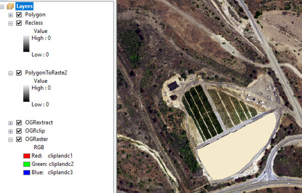

I am trying to refine the results of a supervised landscape classification analysis by removing large bodies of water whose reflection overlaps with the signature of an impervious class. I am working with a multiband raster (RBG) and have tried a few workflows but have yet to achieve the desired results.
Workflow 1: Create a polygon around the desired areas --> clip raster --> extract by mask
Workflow 2: Create a polygon around the desired areas --> Polygon to raster --> Reclassify --> Set Null
Workflow 1 yields the opposite of what I want, while Workflow 2 creates a raster that lacks the RBG bands and is blank. I suspect it is an error in the reclassification step, but I am not sure.
Any suggestions/ ideas would be greatly appreciated.
Desired areaDesired area
Workflow 2 issuesWorkflow 2 issues

I found an alternative that yields the desired results, the workflow is as follows: 1st. Using the Draw Menu create two polygons (one of the total extent of the raster), the second for the area that needs to be excluded. 2nd. Use "Graphics Operations" from the drawing menu and select "Remove Overlap". 3rd. Convert them to features (.shp) using the "convert graphics to features" and lastly 4th. "extract by mask"
