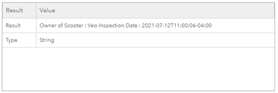

I am trying to label symbols in AGOL and I wrote this arcade but I can't remove time from date?
any suggestion.
"Owner of Scooter" + " : "+
DomainName($feature,"vehicle_company")
+" Inspection Date : "+
Date($feature.CreationDate)

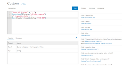

anonymous55
This one doesn't give me the date
jcarlson
MVP Alum
The function is "Text", not "Date".
