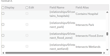

Flag within an HTML pop-up. You also can't select to display a related column within the pop-up by default from the drop down list like you can within the old map viewer (using the same routing showed above). For example, in the old map viewer:

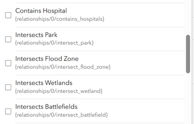

What's interesting, is that it seems like this functionality is potentially already built into the new map viewer, but they haven't made the option available? When you go to the pop-up field list drop down in the new map viewer after following the above workflow, you now have access to all of the related fields using the classic relationship routing:
