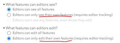

For example, if I changed the Creator field in a feature layer from one username to another, would the second user then be able to pick up those features if the underlined settings below were toggled on?
Thanks.

Ah ok. Thanks for the suggestion. Unfortunately thats not quite what we are after. We need a way of the user actually owning those features so that we can make use of the settings I mentioned above. I.e. making those features their own features. Do you know if there is a way to do this? Or what key is used to define actual ownership of features in AGOL?
many thanks
