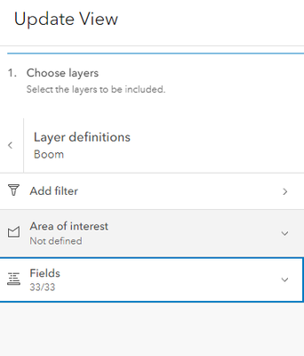

Just to confirm, on the Update View page, how many fields does it show being available?

Unfortunately not all fields. There should be 34 available:
In the Feature layer I have 36 fields in de Data tab and in the view there are 35.
Maybe its because I uploaded the FL in an earlier version of AGOL through Pro.
