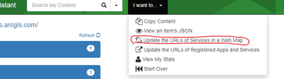

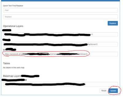

e_mcc
If you still have the issue and you don't want to lose your map settings, I would suggest the following:
  • "download" the feature service from AGOL to your local machine as a GDB format (this will save your fields names and settings).
  • In ArcGIS Pro, add the only feature class that has the issue, reproject it to the correct settings (without M values)
  • Publish the new layer only to a new AGOL feature service.
  • use this tool here ArcGIS Online Assistant (esri.com) to access your original map service and then change the URL of the old layer to the new FS layer.
  • You will have one map service but 2 hosted feature services.
Cheers,
E.
