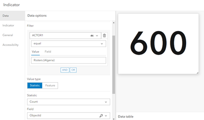

First add an indicator and select your data layer. Add a filter so that InjuryType1 is equal to your gunshot value.

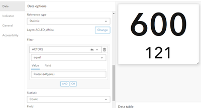

Scroll down a bit and expand the Reference section. Change the Reference type to Statistic. Select the same data layer as before, but this time set up your filter to focus on InjuryType2.
The reference value is now displayed at the bottom of your indicator.

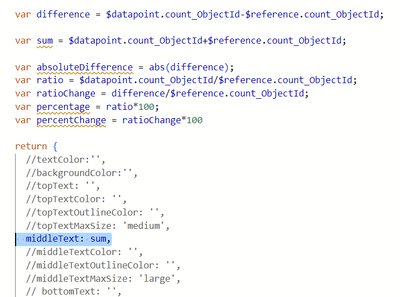

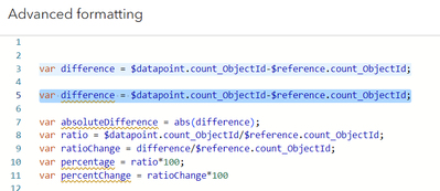

You will notice, that some formulas have already been provided for difference, percent, etc. However, there is not one for sum. We can easily add one. Find the difference formula and copy/paste it into a new row.
Change var difference to var sum and replace - with +
Now scroll down until you find middleText. Uncomment it by removing the // in front of it if need be and middleText: sum,

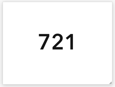

Click done. Now we have an Indicator with the sum of two fields.
