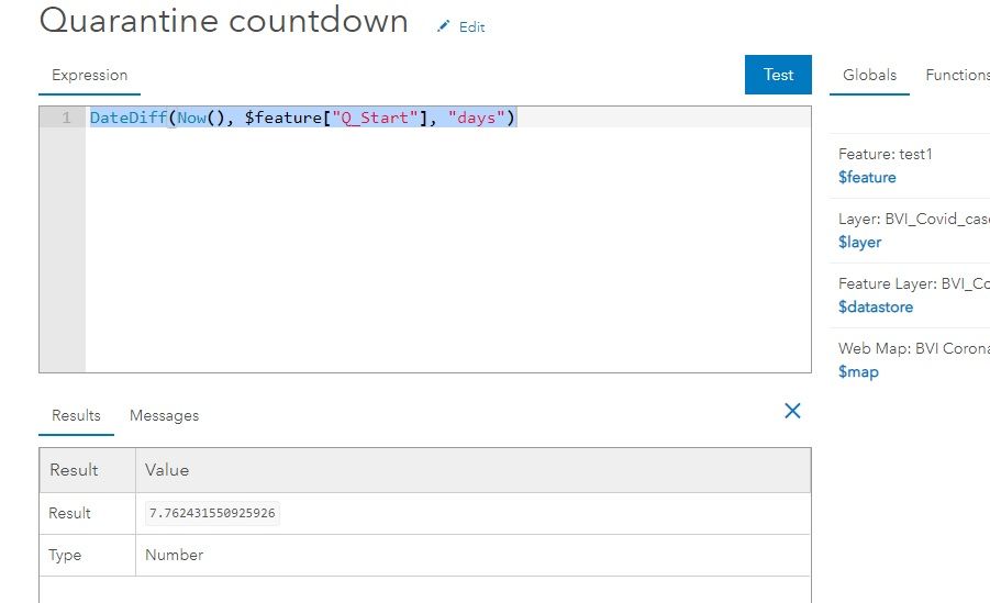

I made my first attempt with your solution (i.e. using the datediff function). Please see attached image. It seems to correctly do the calculation except with the decimal figures. I'm guessing there needs to be a round function somewhere based on my research? Also, can you explain the symbology part a bit more... I'm using ArcGIS online and Im guessing the last part of your solution refers to "change style" and adding a new expression in there? Please advisedatediff_results.jpgdatediff_results.jpg

My Javascript is pretty poor, but the following returned what I was suggesting (I manually entered the start date as I have no data).
var dateDiff = DateDiff(Now(), "2021-01-01 00:00:00", "days")
if (dateDiff >= 14){
    return "Quarantine Expired"
else{
    return "In Quarantine"
yours would look like this I guess:
var dateDiff = DateDiff(Now(), $feature["Q_Start"], "days")
else{
regards the symbology, I would use this expression to create a new field such as "Quarantine_Y_N", then just use the normal symbology window to classify by field value (unique values etc.)
The decimal issue shouldn't be a problem, but it depends of course if you mean 14 days inclusive of that day so far, or 14*24 hours.
Although not rocket science, It would hurt my head too much at the moment to figure that out.
