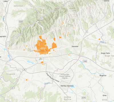

When I open map viewer and add layer from url, everything works fine:

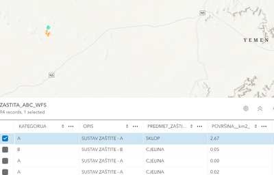

However, when I add url as a new item on AGOL and then open it in map viewer, projection is off.

The capabilities document for your WFS lists EPSG 3765 as the default CRS - <wfs:DefaultCRS>urn:ogc:def:crs:EPSG::3765</wfs:DefaultCRS>
EPSG 4326 (WGS84) will be available by default too (see https://enterprise.arcgis.com/en/server/latest/publish-services/linux/wfs-services.htm#ESRI_SECTION1...)
Examining the web traffic while testing the two different workflows shows that when adding the layer within map viewer, the GetFeature requests specify that EPSG 3765 is the desired CRS for the features (SRSNAME=EPSG%3A3765 is appended as a request parameter). Features are returned correctly in this coordinate system and displayed in the right location.
When opening in map viewer from the content item, the requests instead specify EPSG 4326 as the desired CRS. The WFS does correctly return features in this coordinate system as per the request, but I believe that Map Viewer is for some reason interpreting the coordinates as though they were in EPSG 3765 - which results in them appearing elsewhere.
I'm not sure why the second workflow causes Map Viewer to request the features in EPSG 4326, or why it does not interpret the returned results as being in this coordinate system. It's possible either that this could be a Map Viewer defect or that adjusting the WFS configuration could help.
It may be best to contact your local Esri distributor for further technical support with this. If there is a defect at play, they will be able to get it logged for you. It might also be worth testing whether the same issue occurs if you set your organisation's default basemap to one which uses EPSG 3765? (https://doc.arcgis.com/en/arcgis-online/administer/configure-map.htm#ESRI_SECTION1_1224F13B9D2B451DB...)
