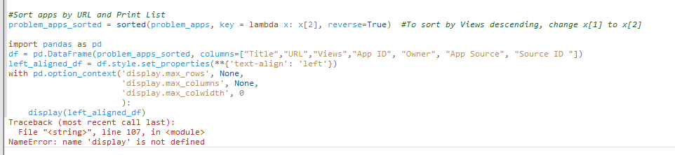

I'm trying to run the scrip mentioned in this help article to see if my org has any deprecated configurable apps in use. However, I get an error "NameError: name 'display' is not defined".
Any suggestions on how to fix this script?

AdamMesser1
@RobertBlashadmin , the code needs the line "from IPython.display import display".
The pandas section is formatting the results for improved readability and so it could be copy/pasted into a spreadsheet. Alternatively, you could simply print the problem_apps_sorted list.   -- Realize this is an old post, but in case others stumble with this as we near the end of the deprecation period.--

WorcesterGTSS
The pandas section at the end was causing problems when I ran this script so I removed that section and added an additional line at the end: print(problem_apps_sorted). This worked for me.
