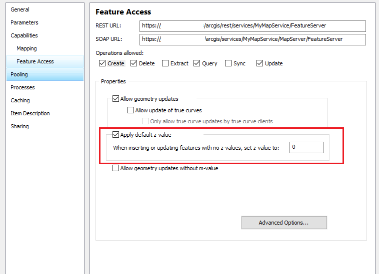

Does the line feature class contain Z values?  You can check by opening the attribute table and looking at the SHAPE field.  It will state 'PolylineZ'.  If it does, you will want to make sure you specified a defaul Z-value when you published the service:

Thanks Jake. I checked but in the "Properties" area it stated that there are no properties for this capability.
