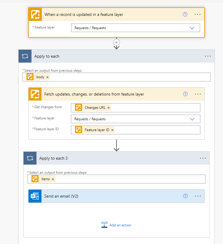

Hello Everyone,
I am in the process of configuring the Citizen Problem Reporter for our community. I have created several Power Automate flows to email citizens when a request is submitted, updated, or when comments are created. I am running into an issue when I try to configure the flow to send emails when only certain fields in the request feature layer is updated. I have tried several different things with no luck. So I am looking to the community for help.
How would I configure the Power Automate flow to only send emails when certain fields are updated? The flow below works if any field is updated in the feature layer.

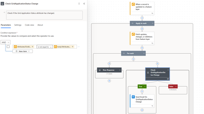

Hi EdDean,
After a few iterations on Power Automate last night, trying to get this to work, I have finally found the workflow. The workflow that you've started is correct, however, you are missing the for each and logical function to test the data. In the example below, I want to send an email when the field GridApplicationStatus changes, therefore I can cater the email for that specific attribute.
1. Add the ArcGIS trigger (when a record is updated in a feature layer - in this instance)
2. Fetch updates
3. For each (the output from previous steps will be body/items
4. Conditional - the conditional expression will look something like this: AND - Attributes/(insert your attribute here) IS NOT EQUAL TO body/Attributes/(insert your attribute here). What this is doing is taking the change log of the attribute we are testing and comparing it to the original data to see whether a change has occurred. If not change has occurred on that particular attribute, no email is sent. But if a change has happened, then vice versa.
Hope this helps

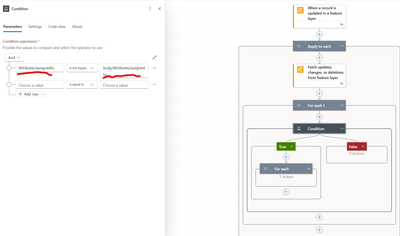

Any luck? I've had the same issue to make it work like the screenshot.
